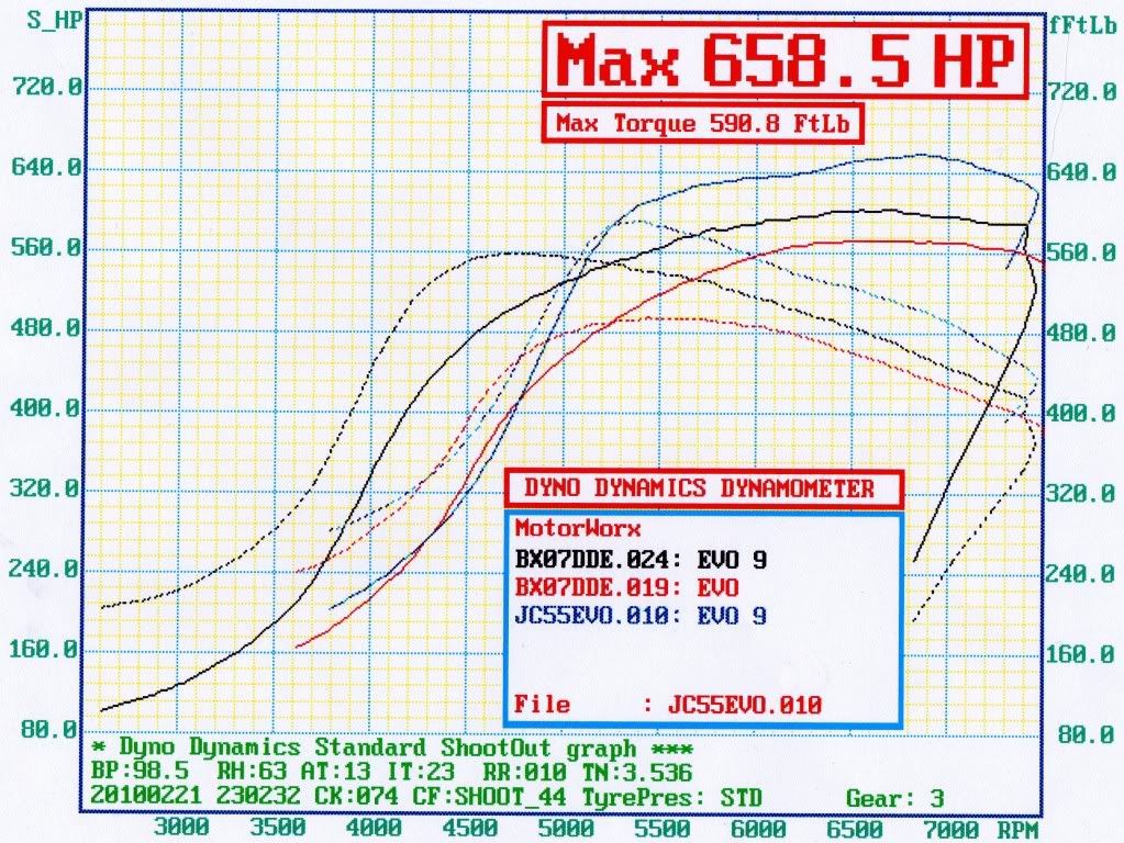

        • This is S200SX and EFR7670 and then a GT4088, You can compare the GT40 and 7670 to the 8374 graph on here as they are the same spec engines.
