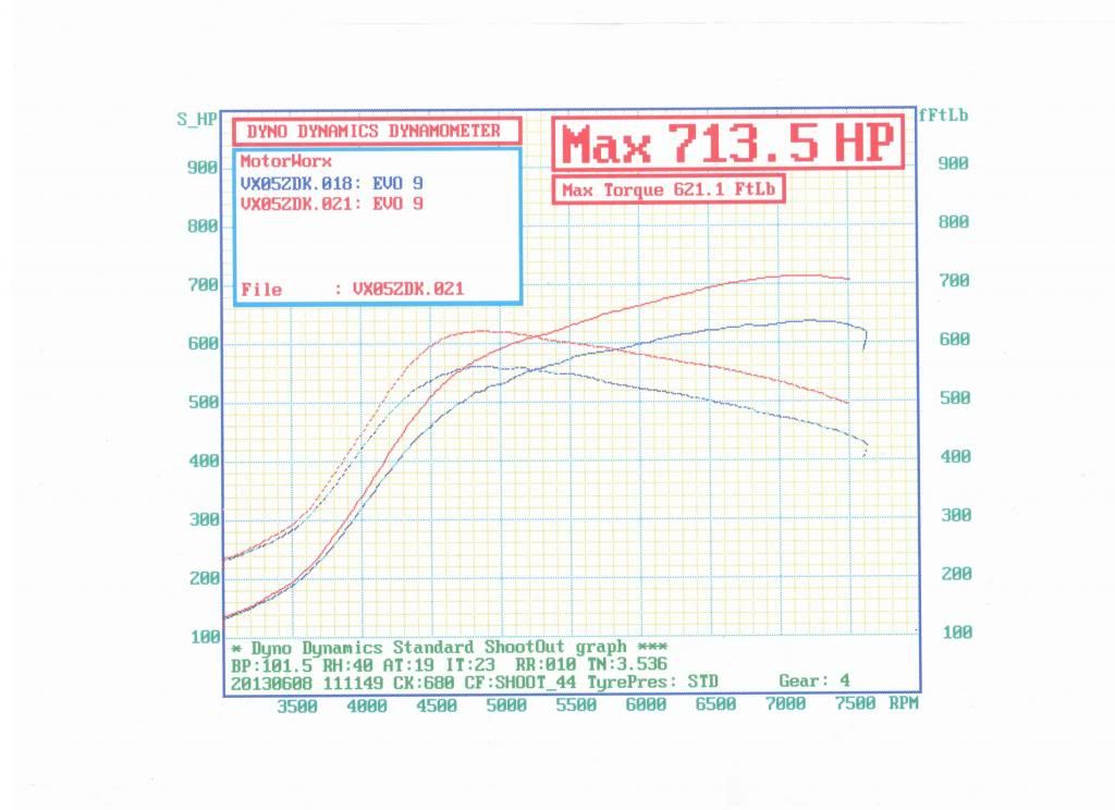

                          • EFR 8374 running hard all year like this,
                            http://youtu.be/KPUvE_JMZGc
                            http://youtu.be/mbQUN2eLlYA
                            713hp in the wet and crap suspension shows it can be driven with care
                            http://youtu.be/s4Emka95Rkk
                            http://youtu.be/x_q29TMpVO4
                            http://youtu.be/JoGoK5Wi2j4
                            There are many more of this car.
                            • Pump and race fuel

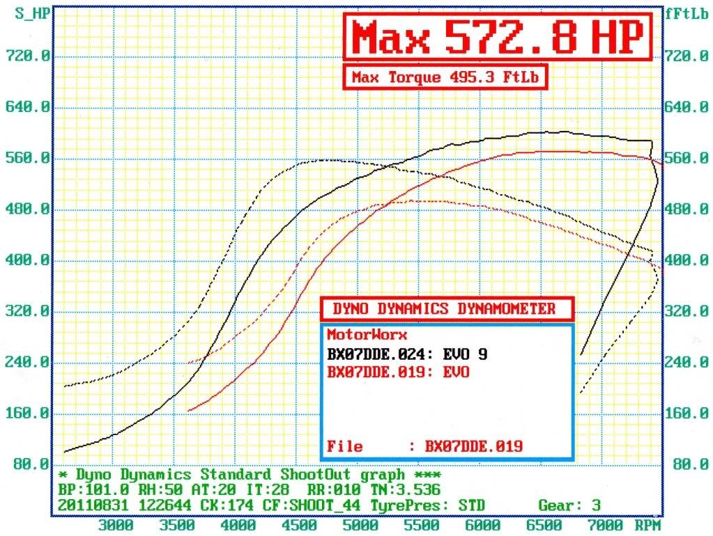

                              • This is the same engine with no change other than swapping to a S200SX twin scroll from a GTX3071 open scroll.
