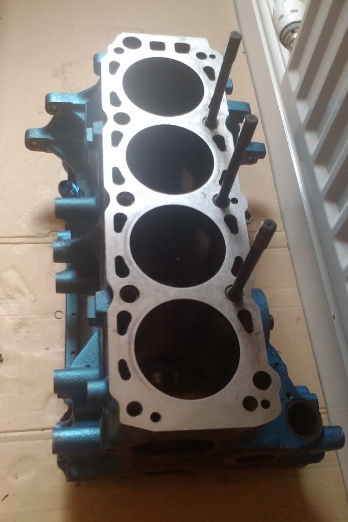

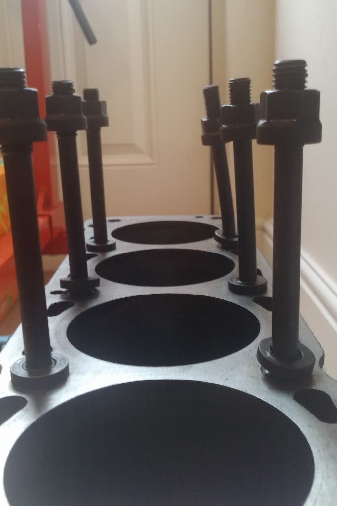

    Pete mason did mine , took it to joe at gsmotosport in Essex and he had it sorted for me top job
      My power is only 550ish but I had 10 studs as one of my corner threads was stripped and I didn't want a helicoil,
      Can't remember cost but it was a bit cheaper than 440,

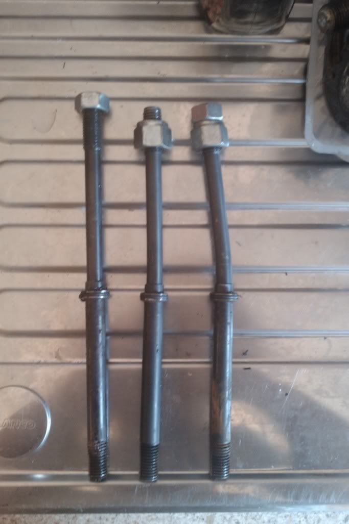

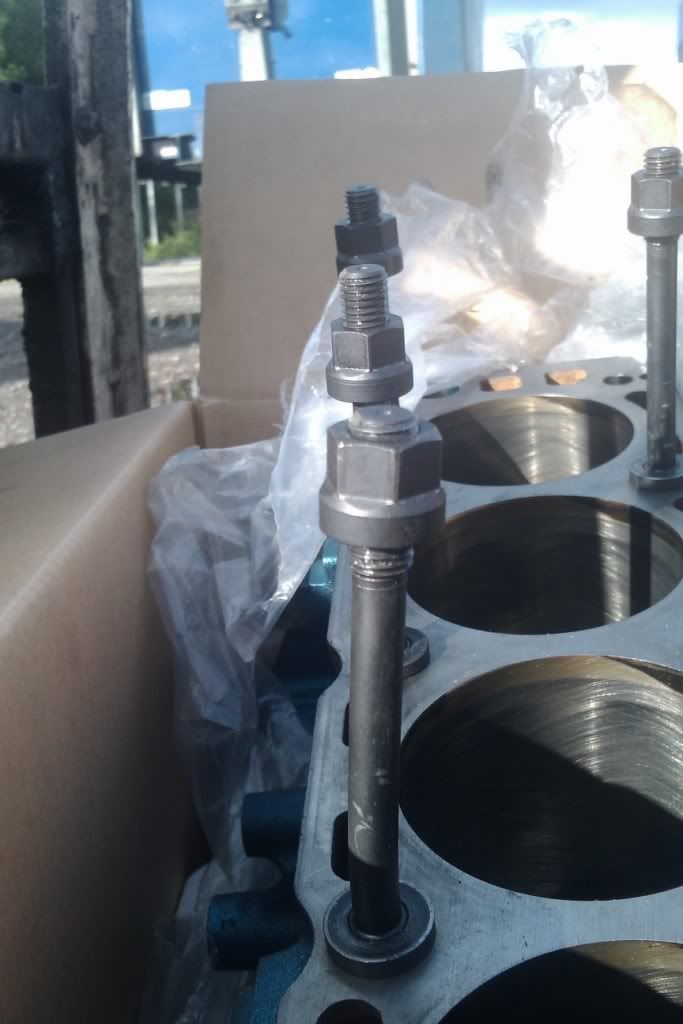

        I had the same problem as Dave but i wasn't so lucky, paid for palleted service with them supplying pallet and this turns up

            should never of been sent out so that could happen.
              why did they not just take the studs out.
                That's what I was thinking
                  Originally posted by Monster View Post
                  Not god Chris, which company was that?
                  Can't remember exactly some company from the midlands
                  They don't come out, well they do but it was supposed to be strapped down on a pallet in a hardened box but instead they missed out the pallet and the rest i don't want to think about - was compensated for a new set of studs though
