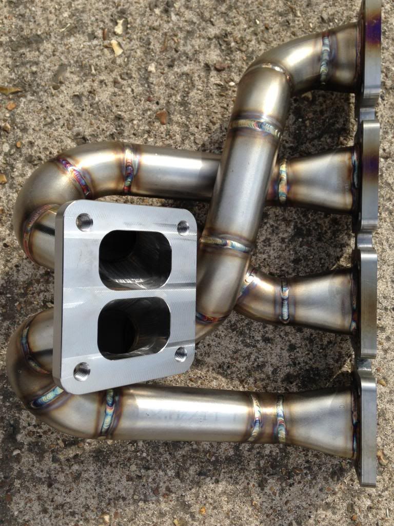

                Use a nice twin scroll manifold to get the full gains.
                  Thanx, will look in to it
                    Here is one
                      Genuinely the twin scroll setup is worth the extra cost...
