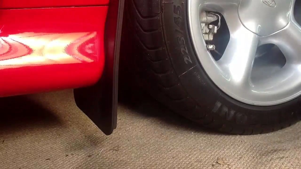

                            Here's a quick video I took hope it works?
                            You can here the slap for the first few seconds or so
                            http://i272.photobucket.com/albums/j...cc57a73993.mp4
                              you sure its the bottom end and not the top, ?
