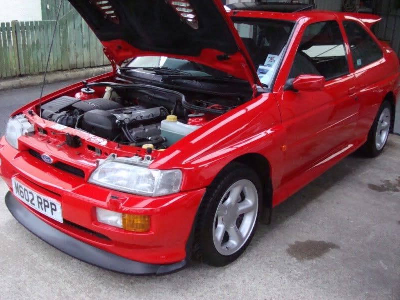

                100% lifter i would say after listening to it at home on my pc, doesnt even last 20 seconds and it quietens down i wouldnt worry. Looks bloody clean by by the look of the wheels and brake caliper, anymore pics.

                  Pic for you dude
                    Lovely example mate
