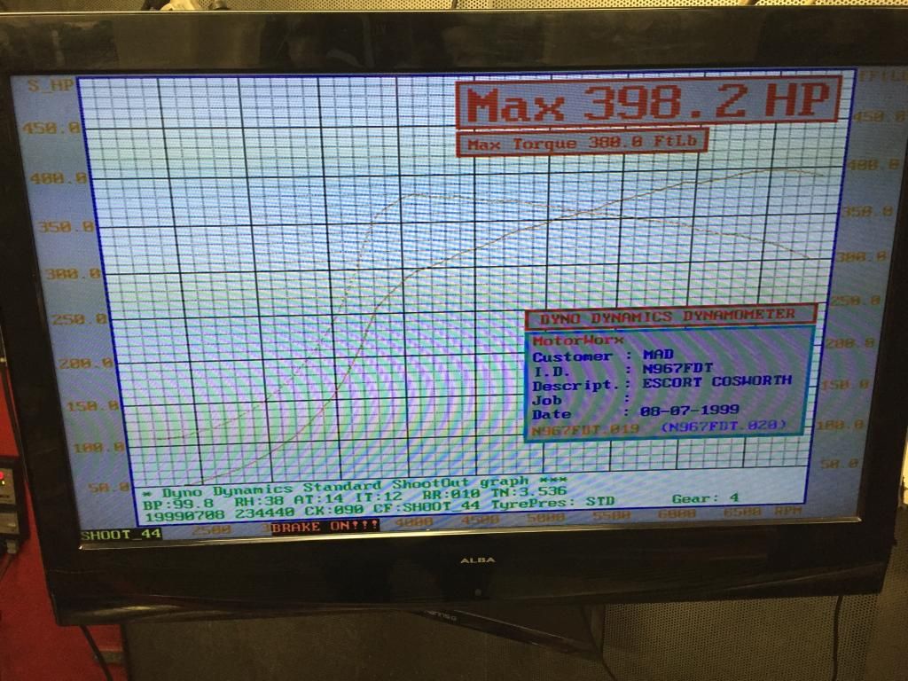

      On the dyno today and one main problem with stock intercooler over 50c intake temp so killing power and Tq is a bit down on what I was expecting and as this has vernier pullies I think cam timing is a bit out lowering TQ,
      I was expecting TQ to look more like this at peak TQ
      The Escort is running 25psi boost.
      • #63
        Just checked the 420ftlb one was running 2psi more boost in the midrange which will pict the TQ up a touch.
